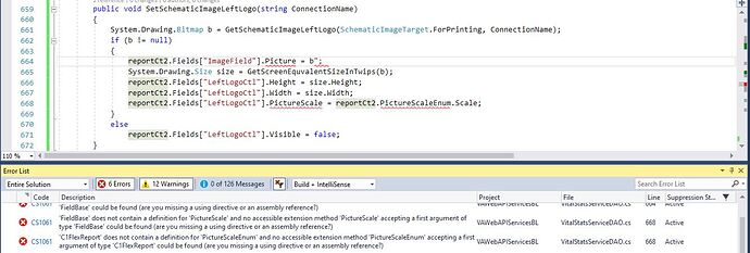

    reportCt2.Fields[“RightLogoCtl”].Picture =“{DataField}”;
    reportCt2.Fields[“LeftLogoCtl”].PictureScale = reportCt2.PictureScaleEnum.Scale;
    The above line of codes throwing error while using C1FlexReport reportCt2
  • Posted 25 October 2023, 3:07 am EST
    Hello fanoos,
    This error is thrown because the Fields property of FlexReport gets the collection of Field objects, but you are trying to access the ImageField object’s property.
    To solve this, please try to cast the Field object to the ImageField object as follows:
    ((ImageField)report.Fields["ImageField"]).Picture = "Picture";
    ((ImageField)report.Fields["ImageField"]).PictureScale = PictureScaleEnum.Scale;
    Please refer to the attached sample for implementation. (see FlexReport_Image.zip)
