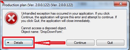

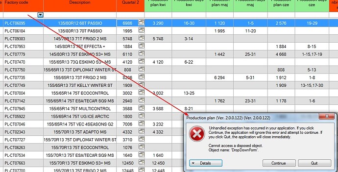

    I made one application while ago where i use filter drop down. On some computers users get error when just clicking on arrow…
    Any idea what to do?

    In order to investigate the cause and resolution, stack trace is required. I am writing down the steps to see stack trace, for your users :
    1. Exception is thrown and this error screen is displayed -
    2. Now, the user needs to click on Details button. It will show some additional text which was previously hidden.
      Kindly copy that text and save it in a Notepad file. Next, you can share that get that file from any of your users.
    Meenakshi
  • Posted 6 July 2018, 1:48 am EST - Updated 4 October 2022, 2:06 am EST
    As i answered above, when user click on details, message is displayed:
    Maybe because is dropdown, same as in grid??
    And when user click OK, application end itself.
