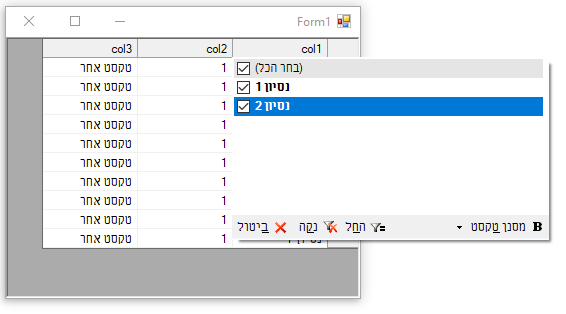

  • Posted 4 October 2017, 12:50 pm EST
    Hi Ruchir,
    THANK YOU!!! I’ve tested the 275 build and the issue is FIXED!
    However i still have a few problems & questions…
    • “Problems:”
    1. In Condition filter the header is still Left aligned (As seen in the attached ‘Header Allignment.png’). I’ve highlighted it in red…
      EDIT: Actually, it looks like the entire ‘Condition’ filter is not in RightToLeft layout…
    1. In Condition filter drop-down there is a Hebrew mistake. You ca see in the attached ‘Heb Mistake.png’ - I’ve highlighted the mistake in red, and the correct one in green. The correct one says 'Greater OR equal to - ’ and the mistake says 'Smaller HE equal to - '…

  • Posted 5 October 2017, 4:26 am EST
    Hi Guy,
    Thank you for acknowledging the fix.
    1. We could reproduce the header not aligned bug. Hence it has been forwarded to the concerned person for fix. We will update you once it is fixed.
    2. We could observe the same at our end too. Therefore the concerned person has been notified about the same. We will update you once it is fixed {Tracking ID: 289982}.

    1. The issue of header text wrong aligned in RightToLeftLayout, has been fixed internally and should soon be released. Please refer corrected output for the same.
    2. The issue related to Hebrew text has also been fixed. Please verify the resolution to this using the new build from: http://prerelease.componentone.com/dotnet40/c1winforms/2017-t3/C1WinForms.4_4.0.20173.286.zip
