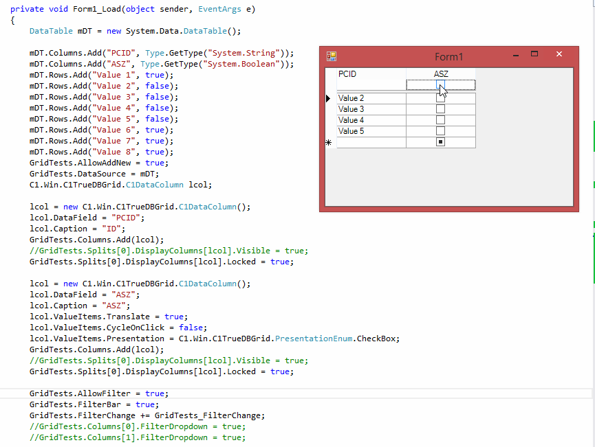

    Please refer the attached sample in which the filtering is performed by changing the checked state of the CheckBox in the Filter Bar. The sample is created using the provide code and it is working fine at our end. Please refer the attached gif for the same.
    In case the sample still doesn’t help, then please modify the attached sample such that it produces the issue so that we may replicate the same at our end as it would be difficult for us to provide you with the best solution without replicating the issue.

  • Posted 27 September 2017, 8:43 pm EST
    Hi Ankita,
    thank you für your example - it runs.
    The difference was:
    My Code: GridTests.SetDataBinding(mDT, “”, true);
    Your Code: GridTests.DataSource = mDT;
    Can you tell my, why my code to not work?
    Thanks again,
    Horst
