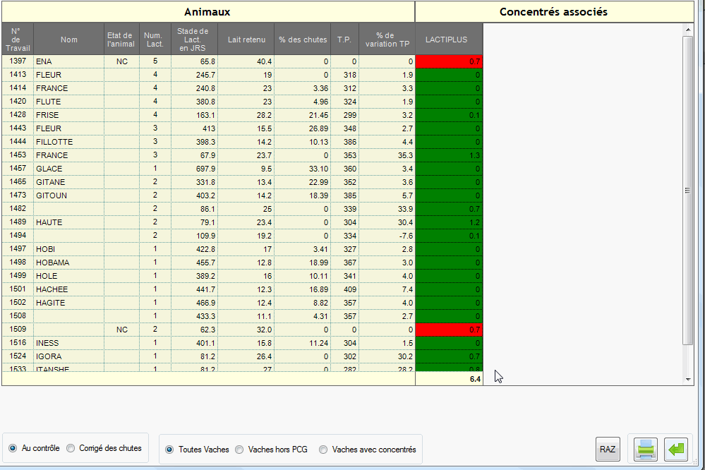

  • Posted 27 September 2017, 9:07 pm EST
    hi,
    I have to modify my grid datasource.
    but my grid make wierd things ( cf picture)
    2016/11/test.gif
