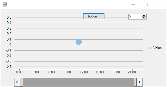

    Thanks for the modified sample. We can replicate the issue at our end i.e., the UpperValue and LowerValue is not reflecting in chart while adding Points more than 5.
    The best approach to reflect the changed LowerValue and UpperValue is to handle with Rendering event.
    private void FlexChart1_Rendering(object sender, RenderEventArgs e)
        _horizontalScrollbar.LowerValue = min;
        _horizontalScrollbar.UpperValue = max;
    Now we can render the last N points(value from numeric box).
    Please refer the attached sample for the same : FlexChartAxisScrollBar_Mod.zip

    1. It can’t be possible to invoke render before Chart UpdateChartsControls. Rendering will fire on every UI changes for Flexchart. So, after AddNewPosition it willl fire.
    2. Try the solution that we have provided previously. It’s working and the Scrollbar updates on every added points which shows the last N points. (see FlexChartAxisScroll.gif)
    The above gif shows the last 5 points which is added to the FlexChart.

    Sorry, maybe I was not so clear in my comments above, but I need fully functional scrollbar. Put it simply, what I need:
    1. there is option in program to track last N points (call it window or range), namely when new points is added and point.Count > N, show N last points;
    2. what I have currently with scrollbar is either it shows whole range(whole points) or
      it is sticked within interval of N last points. After you add 10 points in code above try to use scrollbar , it won’t even move because
    and as a result I lost functionality of scrollbar completely. Why do I need it at all if I can directly setup flexchart min and max? In your gif above it works correct only for showing last N poinst, great, but try to move scrollabr to navigate to other chart region or to show whole chart. You can’t and that is the problem.
    Does it make sense now?

    We didn’t realized that the scrollbar is not movable with our solution.
    This is because of Rendering event. While moving Scrollbar, Rendering event fires and the UpperValue and Lowervalue resets.
    You need to set UpperValue and LowerValue after adding ChartDataPoint with a small amount of delay like you have mentioned. There’ll be no issue having less amount of delay. We need to wait till Axis render on FlexChart. So, that we can adjust the LowerValue and UpperValue of AxisScrollBar.
