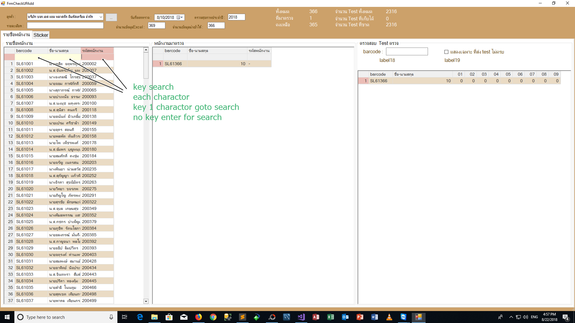

Flex grid search (search i use class FilterRow.cs for search) it use key enter
