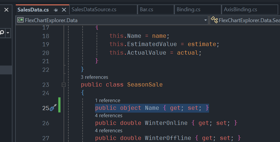

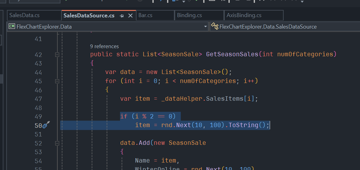

    I have a column of data type object.

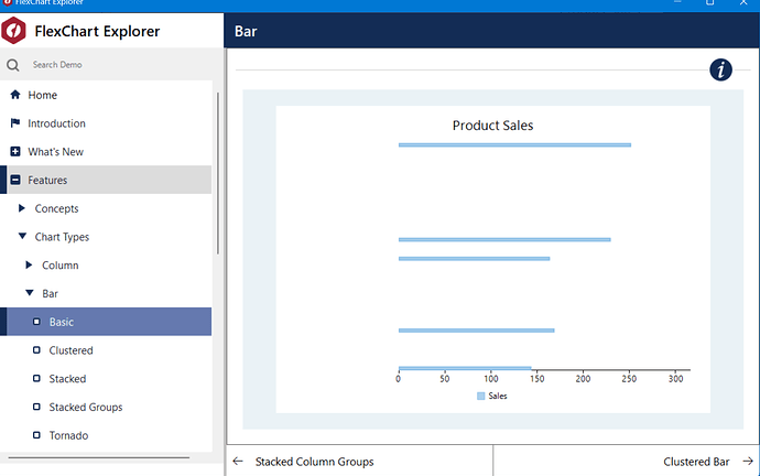

    When my data is a string but the content appears to be numbers, the X axis doesn’t show the value.
    For example: X is 123, 656, ABC…

    However, until then, you can modify your data before passing it to the dataSource. Please refer to the attached stripped-down sample for implementation. (see FlexChart48_ColumnTypeObject.zip)

    As per the developers, mixing string and numeric types is a non-standard situation, and the chart is getting confused by that. So they suggested a workaround for this by adding a property to the data class that converts x-data to a string and using this property as BindingX (chart.BindingX = “XString”).
    public class SampleData
        public object X { get; set; }
        public string XString => X.ToString();
    This would give a clear indication that X values should be treated as strings.
