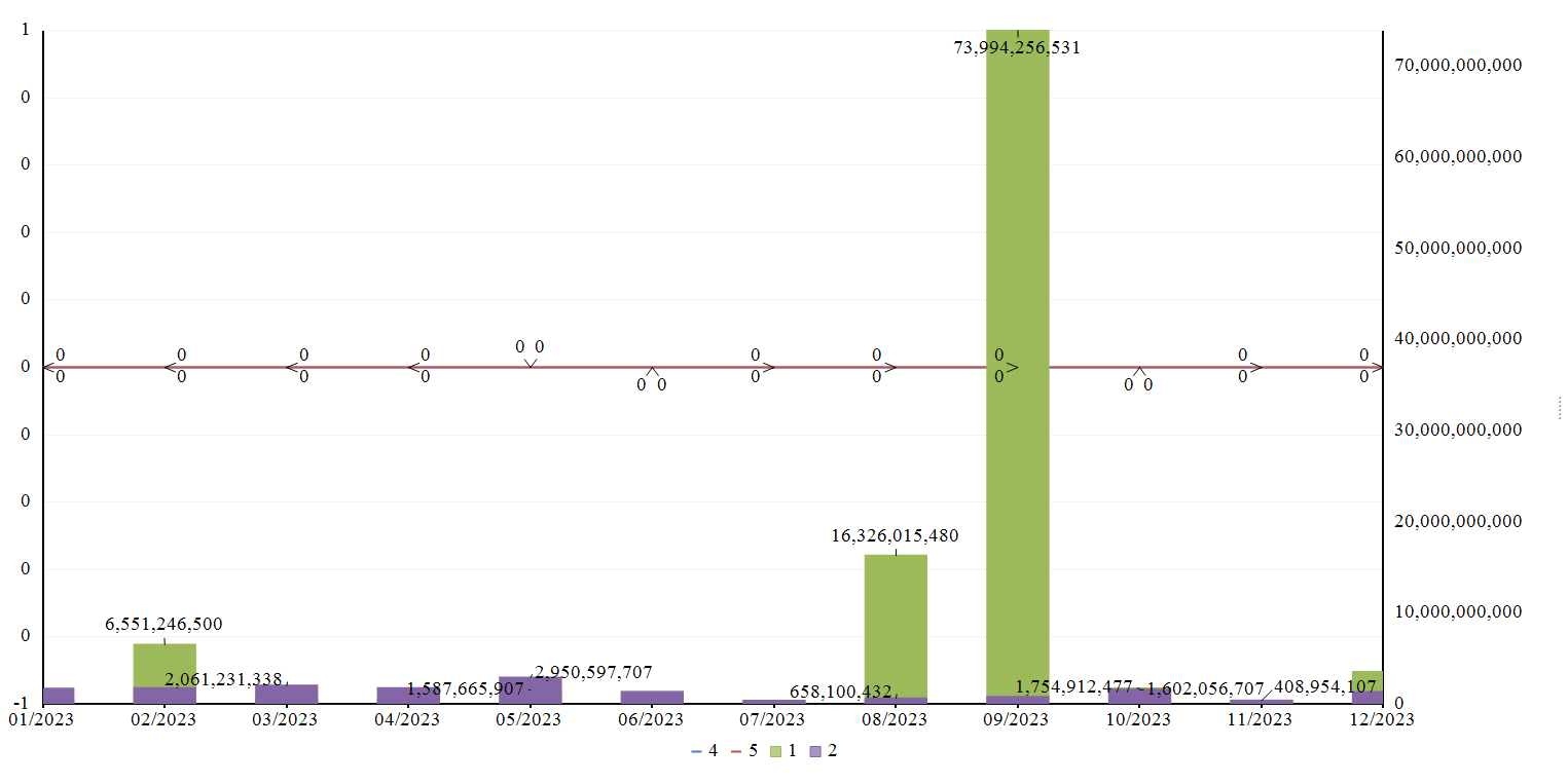

    I have 2 axes displayed on the chart. 1 column axis and 1 line axis. But column axis is always stack. How to make column axis not stack anymore?

    By default, the columns in FlexChart are not stacked. There can be one of the following two scenarios:
    First, when you have set the “Stacking” property of the FlexChart to ‘C1.Chart.Stacking.Stacked’ as follows:
    flexChart1.Stacking = C1.Chart.Stacking.Stacked;
    Second, when you have assigned different y-axes to each of the column series as follows:
    //column series
    var rightAxis = new Axis()
        Position = C1.Chart.Position.Right
    flexChart1.Series.Add(new Series()
        Name = "1",
        Binding = "Y3",
        AxisY = rightAxis
        Name = "2",
        Binding = "Y4",
        AxisY = new Axis()
            Position = C1.Chart.Position.Right,
            AxisLine = false,
            Labels = false,
            TickLength = 0
    Resolution:
    Set the “Stacking” property to ‘C1.Chart.Stacking.None’ (default value) as follows:
    flexChart1.Stacking = C1.Chart.Stacking.None;
    Use the same y-axes for each column series you want to show in the same chart area, as follows:
    //column series
        Name = "1",
        Binding = "Y3",
        AxisY = rightAxis
        Name = "2",
        Binding = "Y4",
        AxisY = rightAxis
    For more info on column stacking, please refer to “WinForms Bar and Column Charts”(https://developer.mescius.com/componentone/docs/win/online-flexchart/bar-chart.html) in the docs.
    Please refer to the attached sample for the second scenario. (see FlexChart48_StackedCharts.zip)
    If this is not how you are implementing things or you have a different scenario, please revert back with the steps to replicate the behavior.
