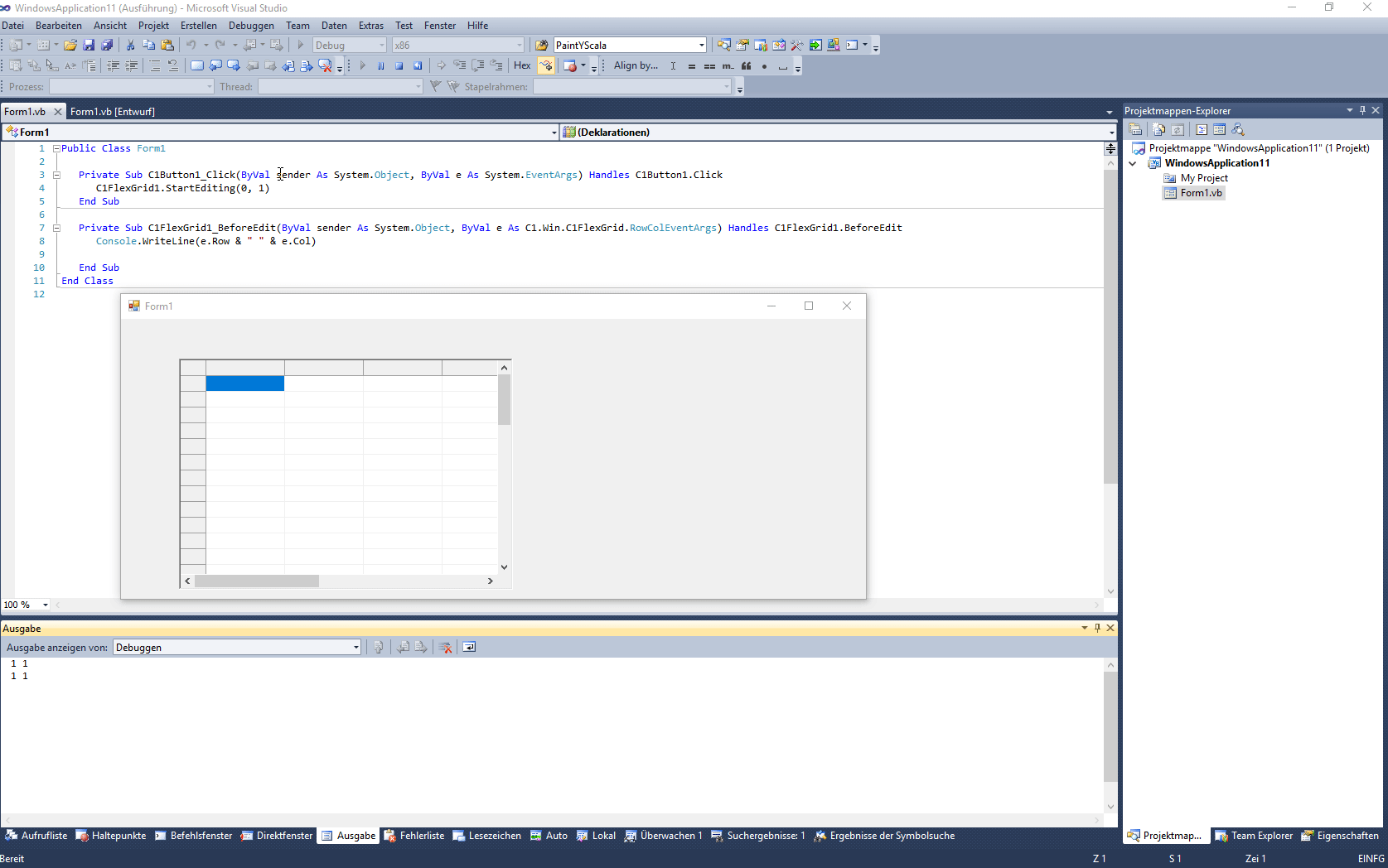

    I have a form with the Flexgrid and when I select cells from one to another by mouse, the event “BeforeEdit” fires many many times. The same situation happens when I use scroll in the flexgrid.

    this is the expected behavior: the “BeforeEdit” event has a misleading name: it is actually fired before the grid renders a cell. Dependening on the result of the event handler, the grid might render e.g. a drop down arrow for editable cells.
    If you want to check whether a cells is editable just before the user starts editing, handle the “StartEdit” event.

    Wolfgang’s explanation is correct. You can use the “StartEdit” event to check whether a cell is editable just before the user starts editing.
