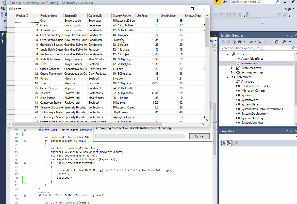

    To resolve this, you can add non-existing values to DataMap before finishing edit (in C1FlexGrid’s ValidateEdit event).
    I’ve attached a sample application to this post for reference. The columns ‘CategoryID’ and ‘SupplierID’ have been set up in a way that their drop-down shows translated values and they also allows entering new values.

  • Posted 20 May 2019, 8:30 am EST - Updated 3 October 2022, 11:27 pm EST
    I do not observe the same at my end. Entering new values (non-existent) in the two columns and moving away by pressing Enter key, the new values persist in the cell. See attached video.
    Is this the same that you’re doing and observing different results?
    In that case, what ComponentOne version are you using? I tested this with latest version of ComponentOne.
