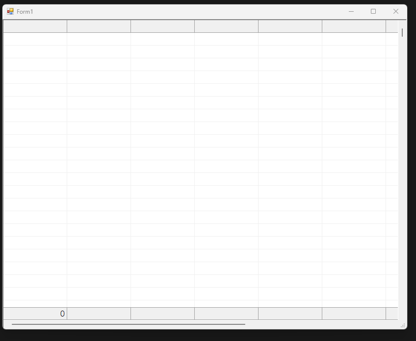

    i have problems display the content of the flex grid when contains a sum footer . (Flexgrid 4.8.20242.688)
    See the sample project…
    Test Flexgrid.zip

  • Posted 23 December 2024, 8:07 am EST
    Hi Peter,
    Since a footer row is already set in the designer, setting the row count to 1 does not seem logical. We recommend either commenting out the line of code that sets the row count in the designer or updating it to 2 (to account for both header and footer rows) for proper functionality. Please refer to the following code snippet for guidance:
    Private Sub AddRows()
      grd.Redraw = False
          'grd.Rows.Count = 2
          For n As Integer = 1 To 2000
              grd.AddItem("")
              grd(n, 0) = n
          Next
          grd.Redraw = True
      End Sub
    We have attached the updated sample for reference. Please check Test Flexgrid_Upd.zip
    As workaround, you can also follow the approach suggested by Wolfgang.

  • Posted 30 December 2024, 4:34 am EST
    Thank you Wolfgang and Aastha,
    this works!
