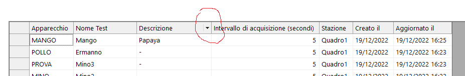

    On my FlexGrid (Winform on .NET 6.0) I enabled for the end-user the filtering on each columns.
    As default behaviour the arrow appears only when the user pass on the header.
    My customer ask to us if it’s possible to see the arrow, for each columns, even if the user doesn’t pass the mouse on the header.
    Thanks Alex
  • Posted 24 April 2023, 9:18 am EST
    I find the solution
    ShowFilterIcon = C1.Win.C1FlexGrid.FilterIconVisibility.Always;
