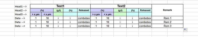

    I need your support for the following challenge: i have to build a Flexgrid that shows data as in the picture attached. So a Flexgrid with 3 headers following with data readed from the database if it exist otherwise it can be input from the user.

    Can you please support and provid a VB Sample to get the Flexgrid with 3 headers as in the Picture?
