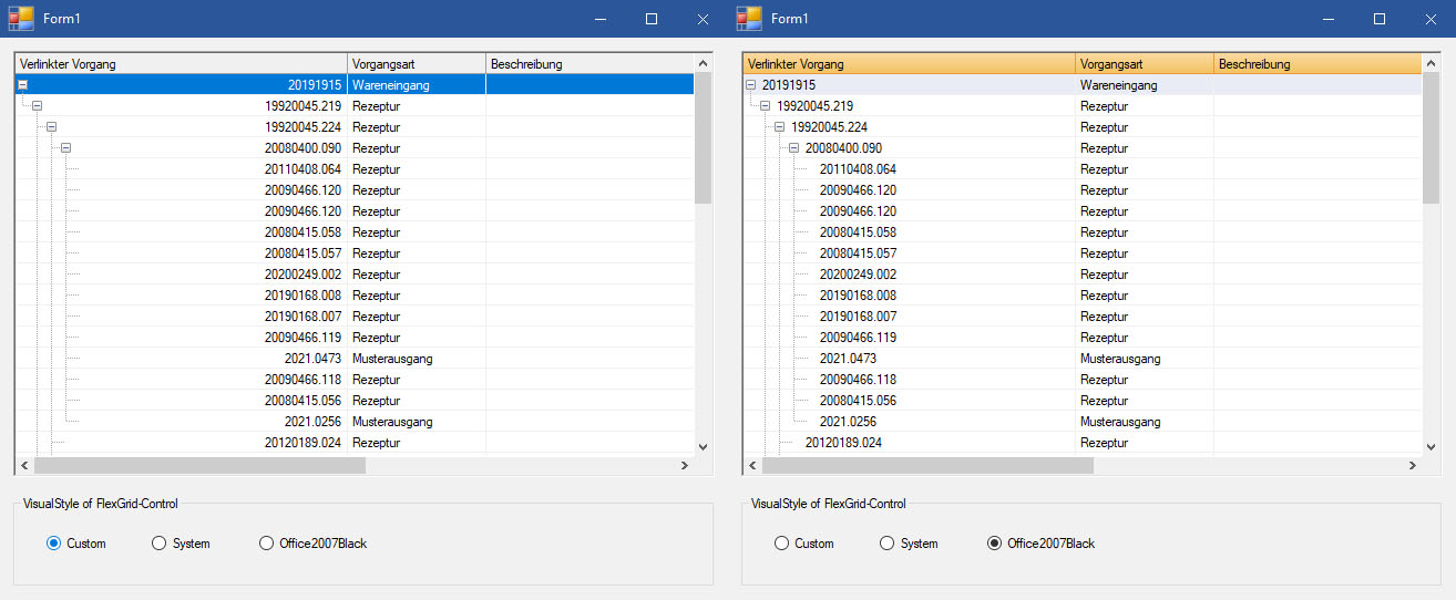

    I noticed a problem in the FlexGrid control that does not allow to set the text-alignment when using VisualStyles Custom or System.
    Normally in the built-in Office-VisualStyles the column is left-aligned. However, as soon as the VisualStyle is set to Custom or System, only right-aligned is possible.
    Attached is a small example program for this.

    a workaround would be to set the TextAlign of the “Normal” style:
    Me.C1FlexGrid1.Styles.Normal.TextAlign = C1.Win.C1FlexGrid.TextAlignEnum.LeftCenter
    Seems like a bug to me. Now it is up to the C1 support to comment on this.
    But I suggest not to use the VisualStyles. They were removed in the .NET 5 version of C1FlexGrid. The suggested replacement is “C1ThemeController”.
