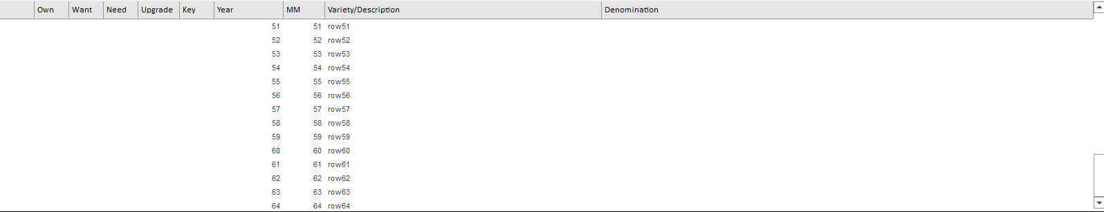

  • Posted 12 August 2022, 10:18 am EST - Updated 3 October 2022, 10:17 pm EST
    Here is the most stripped down version of populating the grid I could do:
    foreach (CoinCatalogGridModel coin in coins.ToList())
                            string strPotentialDenomination = "";
                            fgdNav.Rows.Count++;
                            intCurrentRow = fgdNav.Rows.Count - 1;
                            fgdNav.SetUserData(intCurrentRow, 0, "row" + intCurrentRow.ToString());
                            fgdNav.SetData(intCurrentRow, 6, intCurrentRow.ToString());
                            fgdNav.SetData(intCurrentRow, 7, intCurrentRow.ToString());
                            fgdNav.SetData(intCurrentRow, 8, "row" + intCurrentRow.ToString());
                            fgdNav.Rows[intCurrentRow].UserData = intCurrentRow.ToString();
                            fgdNav.Rows[intCurrentRow].IsNode = true;
                            fgdNav.Rows[intCurrentRow].Height = 20;
                            fgdNav.Rows[intCurrentRow].Visible = true;
                        string message = $"{coins.ToList().Count} items in list\n\n{fgdNav.Rows.Count} rows in grid";
                        MessageBox.Show(message, "Results", MessageBoxButtons.OK, MessageBoxIcon.Information);
    The first screen shot shows that there are 234 items in the list, and the grid.rows.count reflects that.
    The second shot shows that only up to row 64 is being displayed.
    Hope that helps.
