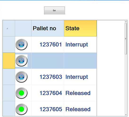

    Thanks for the quik answer. I saw the Video and also have done the changes you mentioned. The selection is working fine. But when the row is higlithed i cann’t see the values anymore. This meams the flexgrid drawing has to be adjust Event oncklik or other event. Can you please instruct how to chage the Colors when selecting one row?

  • Posted 23 January 2019, 5:57 am EST
    Hello Said,
    When a row is highlighted the value cann’t be shown
    To overcome this problem, please use the following line of code in “OwnerDrawCell” event
    DGB.Cols(2).Style.Display = DisplayEnum.ImageOnly
    instead of
      e.Style.Display = C1.Win.C1FlexGrid.DisplayEnum.ImageOnly
