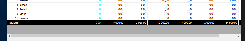

    Is it possible to have a sum(total) row at the bottom of the grid, that always stays at the bottom, and does not scroll with the rest of the rows?
  • Posted 22 November 2018, 6:27 am EST - Updated 4 October 2022, 1:53 am EST
    I mean, like shown in the attached image, where there is a sum line at the bottom.
    And can you force cells in that sum row to merge?

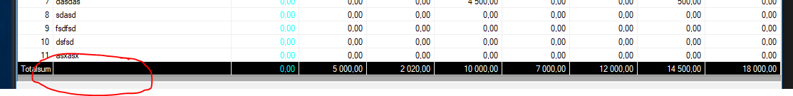

    I can somewhat get something to work, using the FlexFreezeBottom class, but it is not ideal, as when the rows are few, the frozen last row is not staying all the way at the bottom, see:
    I want it to stay like in the image below, and I want to merge the two cells in the red circle, is this possible?
