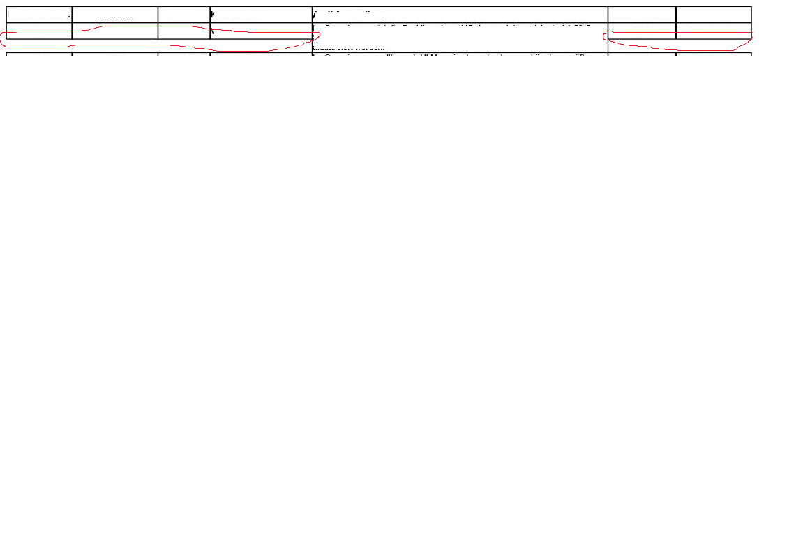

    Is their a way to let all the fields fit to the highest one?
    all the fields have the same border.
    I have attached a picture and marked in red the fields to fit the highest one.

    Thanks for the snapshot.
    As per our understanding, you are trying to adjust height of first four and last two Fields of second row according to the middle field.
    You can achieve this requirement by setting Anchor property of fields(highlighted in snapshot) to TopAndBottom.
    Please refer the attached report sample for the same : DemoReport.zip

    Perfect.
