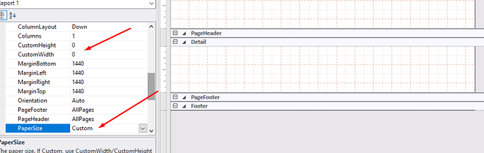

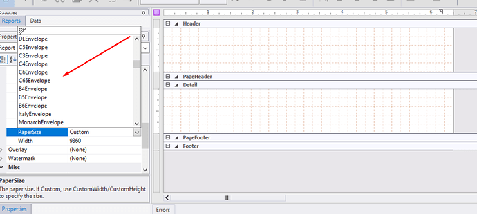

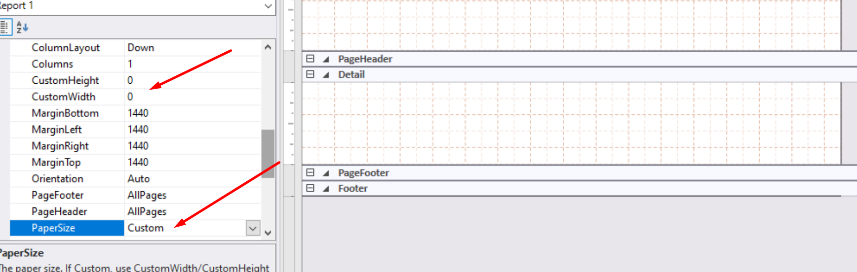

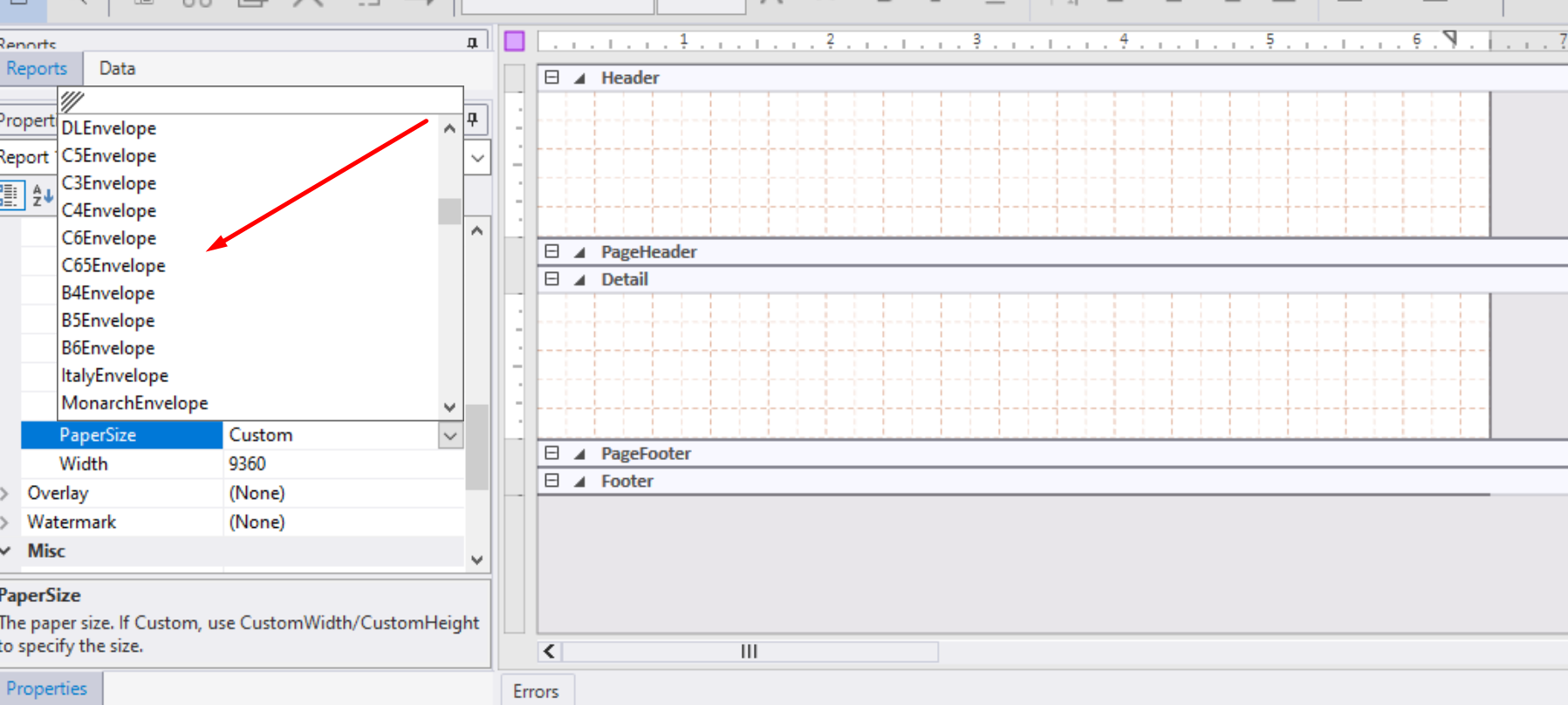

    There are some default Envelope sizes available in the FlexReport that you can set via the PaperSize property under the Layout option. Please see the attached screenshot for the same.
    You can also set the custom height and width by setting the PaperSize as Custom.
