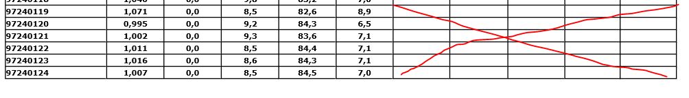

    is it possible to hide Flexreport fields with border if they are empty. see attached picture.

    Thanks for the snapshot.
    You can hide FlexReport Field on the basis of their value. For that you need to add script in Detail.OnFormat as: (see script)
    If (Flag = Null) Then
    FlagField.Visible =False
    Else
    FlagField.Visible =True
    EndIf
    Please refer the attached sample for the same : HideFlexReportField.zip
