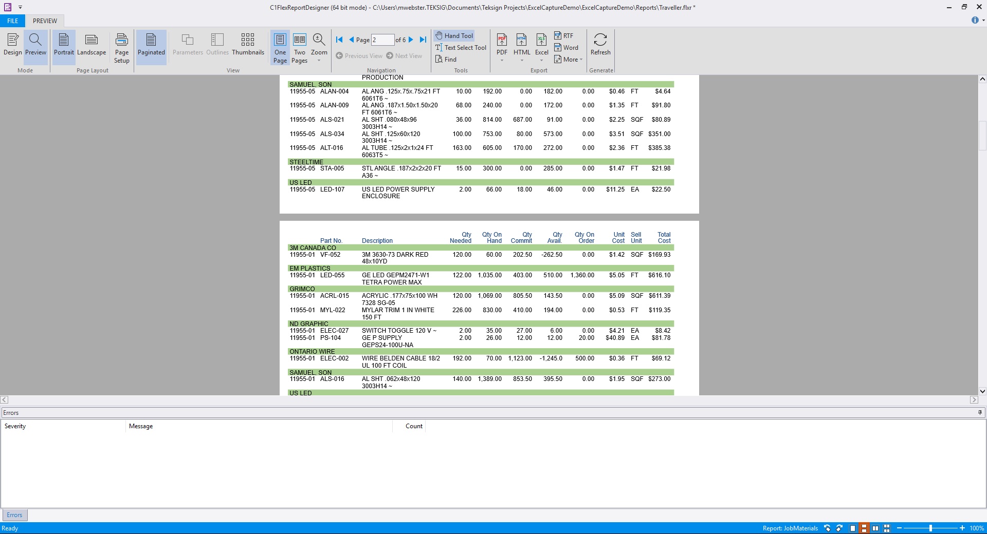

    Thanks for your response. I tried that but it did not work. Please see the attached JPGs. In the first one, I printed my complete report with the sub report in question and I did not get the headers after the page break. When I printed the sub report on it’s own, the second image, I got the headers after the page break. Any idea what might be going on?
  • Posted 24 September 2018, 9:12 am EST
    I should note that my sub report is located in the Report Footer section of the main report. Not sure if that makes any difference - I would not think it should.

  • Posted 25 September 2018, 4:26 am EST
    Hello Mike,
    Thanks for sharing your report but I could not preview it because of the absence of the related data.
    However, I could replicate the issue at my end as well. I have escalated it to the developers (ID: 252281) and will let you know once there is any information from them.

  • Posted 1 April 2019, 4:59 am EST
    ​Hello Mike,
    The issue is fixed with the latest release version. GroupHeader of subreport now renders on all pages in the main report when its Repeat property is set to true.
    You can either update using C1Live or manually download the assemblies from here: http://prerelease.componentone.com/dotnet40/c1winforms/2019-t1/C1WinForms.4_4.0.20191.359.zip
