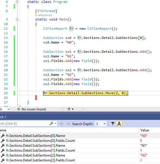

    I have found very strange issue in SubSections.Move() method.

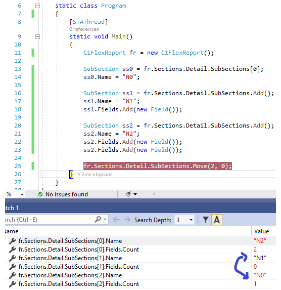

    If I have 3 subsections, and want to move subsection with index 2 to position 0, when I have called Move(2, 0) method, I got unexpected behavior.
    Subsection with index 2 is moved to position 0, but:
    subsection with index 0 is moved to position 2 (if you observe subsection name) and moved to position 1 (if you observe number of fields).
    What happened?
    You can see that on picture I have attached and you can debug in App sample I have attached.Hello guys,

    Thank you for the sample and we too can replicate the issue at our end and escalated the issue to the devs and will let you know once we get any updates on this from the developers’ end.
    [Internal Tracking ID: 431093]
  • Posted 5 July 2020, 12:57 pm EST
    This issue has been fixed in the latest hotfix builds i.e. 4.5.2.20201.424 and you can use the builds in your application to resolve the problem that you are getting at your end.
    You can upgrade the builds via latest ComponentOneControlPanel utility by following below given steps:
    1: Run the utility.
    2: Go to the UPDATE tab under the PRODUCTS tab.
    3: Check the option: Include prerelease and hotfix versions.
    4: Expand WinForms and click the update button.
