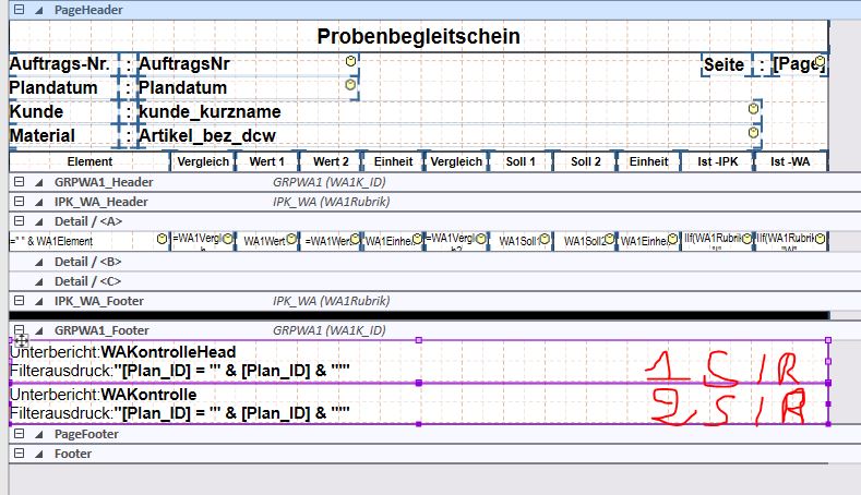

    I have created 1 Flexreport that contains 2 sub Reports. (1 S/R and 2 S/R) as in the Picture.
    The main report is printing Detail records from one table and working fine.
    The first subreport (1 S/R)) Shows 1 head line from one table and working fine.
    The second subreport (2 S/R) is printing detail records from another table. The Problem is, it does not stop printing at the end of the page and continue in the next one. The printing go continuesly.
    I will appreciate your support for dealing with this issue.

    You need to set the GRPWA1_Footer 's SplitBehavior property to SplitIfNeeded so that it can span multiple pages. Then you need to set the SplitBehavior to SplitIfNeeded and AutoHeight to CanGrow or GrowOrShrink of the subsection GRPWA1_Footer .
    Please refer to the modified report attached.
    Avnish
