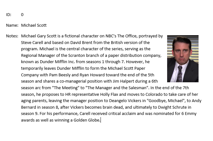

    Is it possible to wrap text around a picture in a flex report?
    Example:

    Sorry to mention that it not possible to wrap text around a picture in a flex report.
