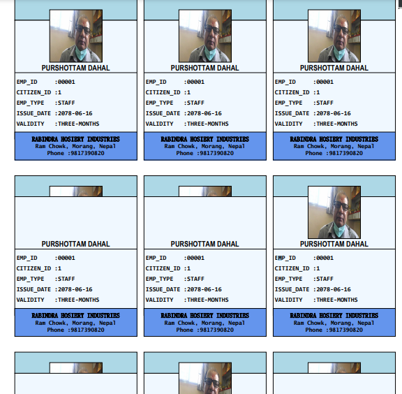

    Please look into below image:-
    Here we have set followings for image field like -
    imageField.ZOrder = 999;
    imageField.SetZOrder(true);
    but problem is it still works for some image and not for other like shown in attached image.
    please look into it and guide us to solve the problem…

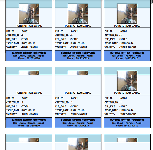

  • Posted 1 February 2022, 3:46 am EST
    Hello Sanjeeb,
    Please see the attached GIF and updated sample which is showing the issue has been fixed in 4.5.2.20213.537.
    Z_Order_Demo.zip
