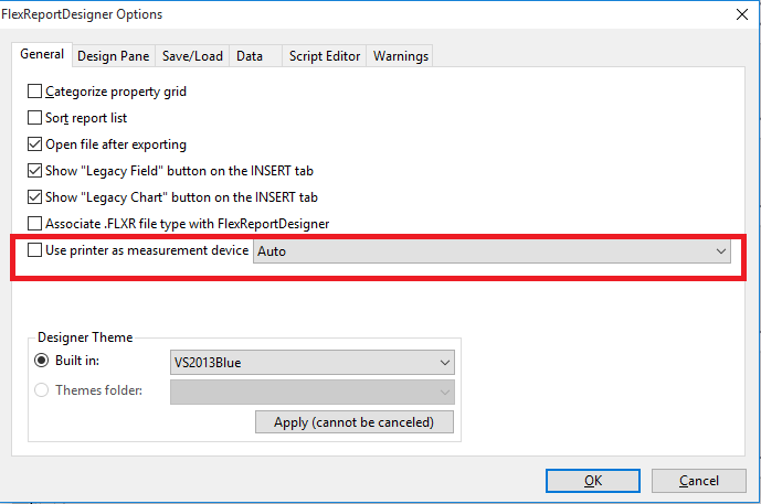

    In this issue, the rtf text was not printed when the report was accessed on RDP.
    With this, the problem looked like bug/limitation somewhere within Direct2D processing in Remote client.
    Thus, as a workaround, the suggestion was to set the following property in the program somewhere before the report rendering:
    C1FlexReport.MeasurementDevice = C1.Win.C1Document.MeasurementDevice.Printer;
    In the designer, the property is found under Options in File menu. One must check “Use printer as measurement device” and select the particular printer (see the attached screenshot).
    Also, one must ensure that the BackColor for the RtfField is set to some value, say White. Without this, the rtf text may not be displayed while a report is printed.

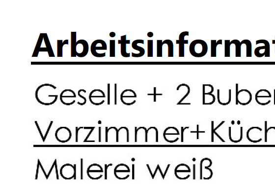

  • Posted 26 November 2018, 1:02 pm EST - Updated 4 October 2022, 1:53 am EST
    Is there anything one can do to get a better/higher resultion for rtf fieldsin a flexreport.
    It seems the rtf field is rendered seperately and with a very low resolution
    please see my screenshot…
    The textfield “Arbeitsinformation” is “normal” textfield
    the rtf field is below this “label”
  • Posted 27 November 2018, 5:00 am EST
    The difference might occur because of the RTF having different style settings as compared to the other report fields. Can you share your report so that I can analyse the same at my end?
