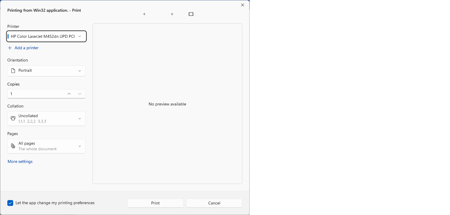

    When I click the Print button on the ribbon menu of a landscape report, the following print dialog appears:
    Which
    Note that:
    The top banner reads "Printing from Win32 application - Print
    The orientation is set to Portrait
    And there is "no preview available
    How can I:
    Set the banner to something else
    have the orientation set to my report’s orientation
    have a preview or don’t show the preview panel

    you use Win 11 22H2 I assume? It seems the new print dialog is broken and a predefined orientation is not applied. You can reproduce it even using MS Paint - if you set the orientation using the “Page setup” menu item, it will not be applied to the print dialog.
  • Posted 13 December 2022, 6:57 am EST
    Hi Kingman,
    So I assume it is not an issue of C1. But I did not find any hints on the web.
    Here is a workaround to restore the old form: https://www.winhelponline.com/blog/restore-legacy-print-dialog-windows-11/
