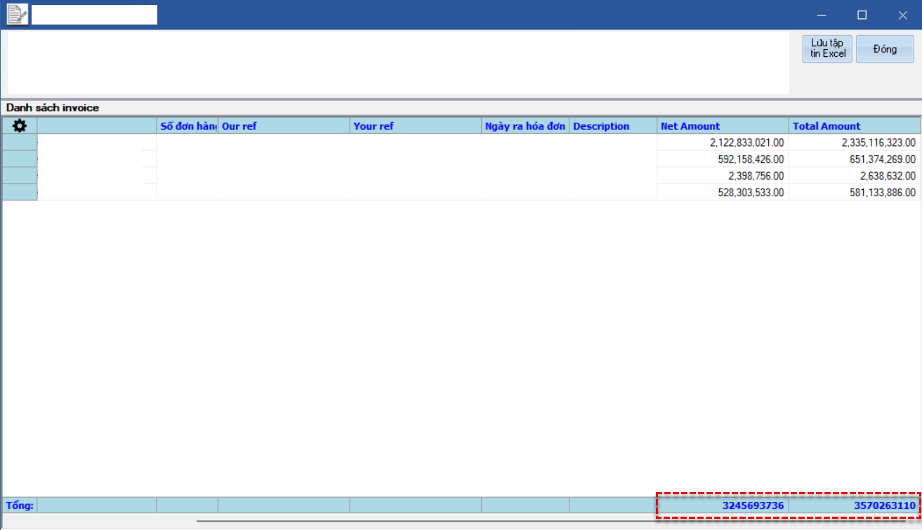

    I am trying to format number for C1Flexgrid Footer, but I could not figure out.
    How can I format number for footer at column 8 and 9 as attached photo.

    To format the aggregates in the footer, you can use the Caption property of the AggregateDefinition class. The Caption property can be defined using the Composite format string, similar to how they are used in the String.Format method.
    Please see the attached sample project for reference - FooterFormat_C1FG.zip
