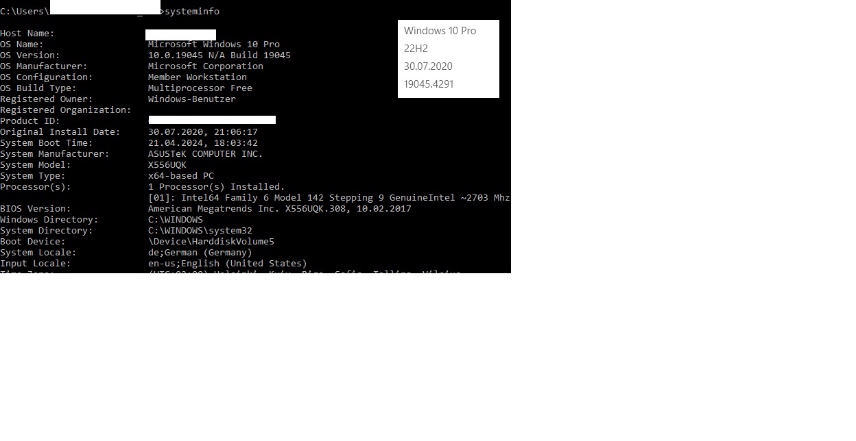

  • Posted 1 May 2024, 9:23 am EST - Updated 2 May 2024, 4:22 am EST
    I have already installed the latest version (4.8.20233.631) of components. Unfortunately, it has not helped. I have only noticed that when I run the program on my colleague’s PC via Remote Desktop, a file with correct frames is created. When the program is started directly on the PC, an incorrect frame is drawn.
    There are several PCs (at least 5 PCs) that have this problem.
    I am almost certain that the problem only appears on PCs with Windows 10.
    System information from one PC:
    (Screen resolution 1920*1080 -The resolution is the same as mine)
    Memory size 16GB
