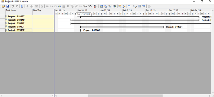

    I’m looking to open a chart that has all groups collapsed when open. I haven’t been able to find a option under properties for this. I’ve also tried to do this in code, but haven’t found a way to get this working. See picture which shows how I would like it to open.

  • Posted 25 January 2019, 4:56 am EST
    Didn’t quite work in VB.net after conversion but with minor changes I was able to get it to work. Definitely pointed me in the right direction. I didn’t think about modifying it that way before. Thanks so much for your help.
