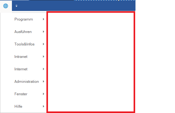

    I’m currently working with the C1Application Menu.
    I ran into two issues:
    1. I want to hide the ‘RightPaneItems’ so there is no empty box (see: red box) showing when I open the Application Menu. Is there a way to do this?
    2. Is there a way to resize the height of menu items from the 1st and 2nd level? (And remove the bold text)
      I’m trying to make all the menu items the same size.
  • Posted 5 February 2020, 5:41 am EST
    1. The right panel cannot be hidden. Also, as I can observe from your screenshot, it appears that you are using menus as in your LeftPanelItems. To be able to display the menu items, the right panel would be needed.
    2. Please elaborate on what do you refer to as the 1st and 2nd level? A screenshot would be helpful to understand the requirement.
