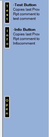

    I have 3 buttons all sized and configured identically (as far as I can tell)
    The buttons require the text to be displayed vertically (top to bottom)

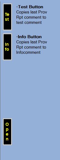

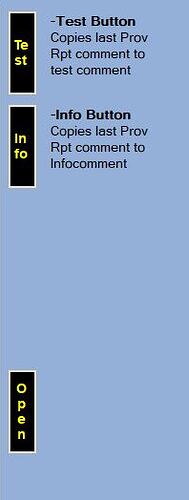

    When I maximize the form two of the buttons (buttons 17&18) wrap the text to two rows of two characters
    The Third button retains it single column of text. 'C1Button18

    When the form is maximized, the C1SizerLight resizes all the buttons in the same proportion, now if there is space for more than two characters then the button will show them in the same line.
    If you want to show one character in each line then you can change the test to include a newLine after every character. Please refer to the sample attached.
