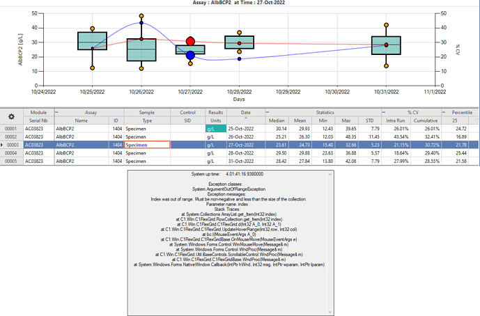

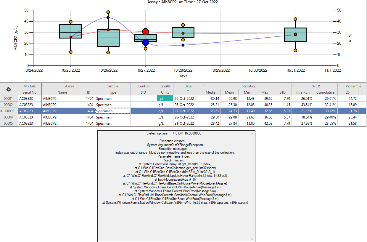

  • Posted 4 September 2023, 5:08 am EST - Updated 4 September 2023, 5:13 am EST
    Correction. It seems to work but If you continuously change the cursor position over the grid, after a few seconds I got the following error. (see screenshot 1)
    Sometimes, error appears after 2 or 3 sec, sometimes I had to mouse the mouse for 15 sec or more before getting the error.

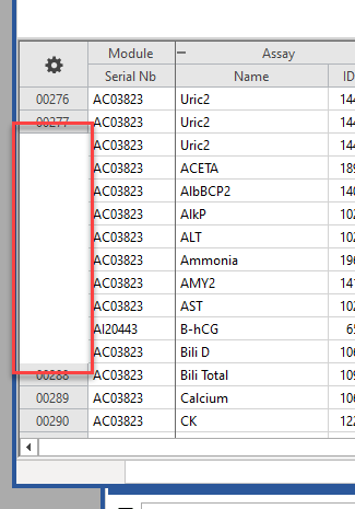

    Note: I also add a screenshot for a problem that I have regularly (also with previous version. I sometimes display the record number in the fixed column. When you scroll with the mouse, it happens sometimes that some numbers are not drawn correctly. (Cells are blank)

  • Posted 5 September 2023, 3:49 am EST
    Thank you for providing all the details. For your information, this exception is observed due to a bug with the HoverMode feature in the 2023v2(611) version of C1FlexGrid. This issue has already been fixed internally and the fix will be available in the upcoming 2023v2 hotfix release. Unfortunately, there is no workaround for this issue currently.
    Furthermore, to show the record number in the fixed column, you should set the e.Text property in the OwnerDrawCell event instead of setting the cell value using flex.Rows[e.Row][0]. Please see the updated code snippet for reference.
