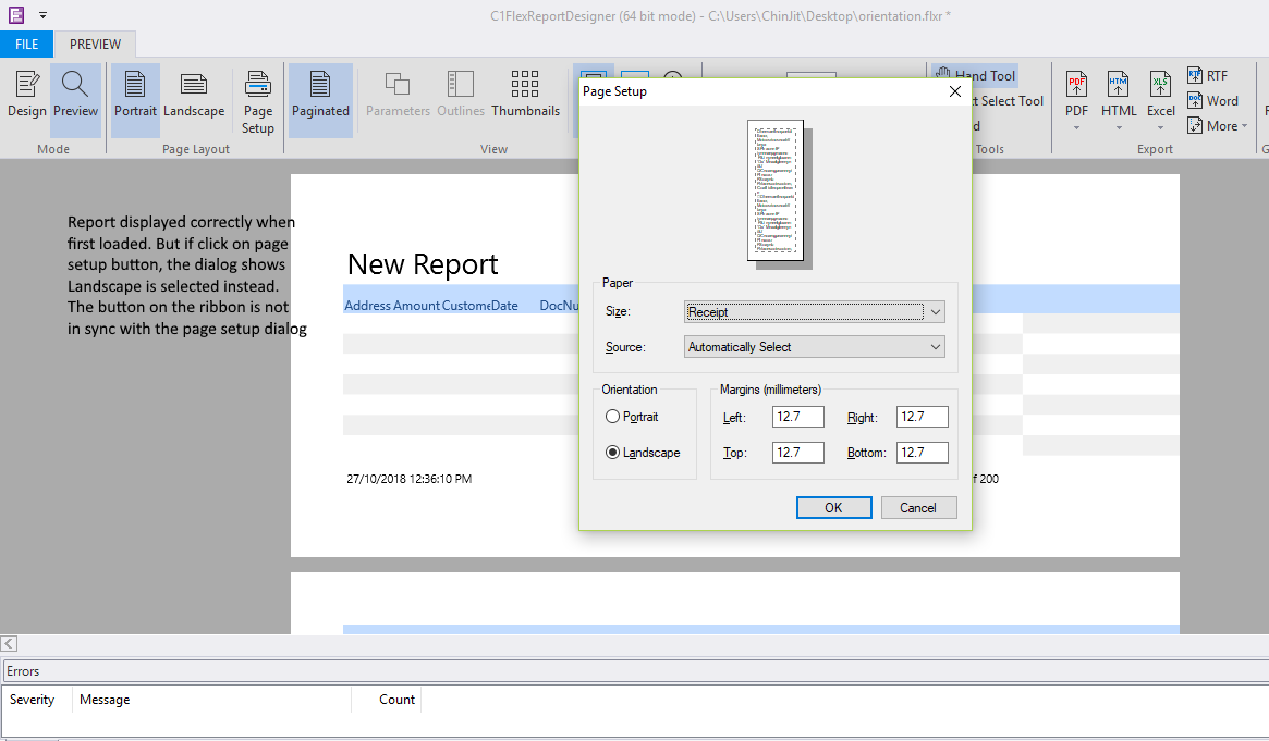

    I created a sample flex report with custom paper size of width 9 inches and height 3.66 inches ( Papersize= custom, Custom height = 12240, custom width = 5280, orientation = portrait ),
    When I click the preview button in flexreport designer, the report is displayed correctly with portrait button on the ribbon selected. But if I click the page setup button. The page setup dialog shows “Landscape” option is selected. It is not in sync with the button on the ribbon.

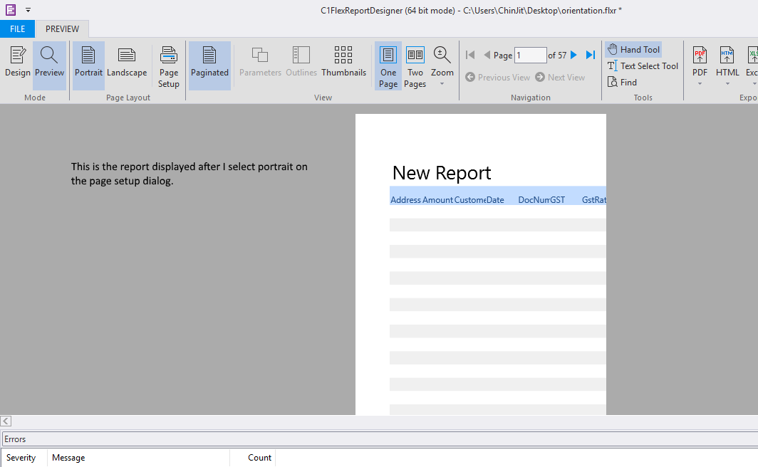

    If I select portrait in the page setup dialog, the report is shown as below.
    It looks like there are some confusions over orientation when the paper width is longer than paper height.

    I would like to clear a few points first:
    a. If the width of the paper is longer than the height, it is considered as landscape. This is the reason why page setup dialog shows Landscape selected in these cases.
    b. The orientation buttons on the ribbon are not aligned to change the layout of the report as per the button click. This, however, can be done as per the formatting based script added to a report. Report layout created for Landscape cannot fit to portrait layout. Attached “rep.flxr” shows the change in orientation based on button click because of related script added to GlobalScripts.
    I could observe that on changing the paper size to the mentioned values, the report pages are rendered as cheque pages (tested with “categories.flxr”). However, the Portrait button on the ribbon is selected at this moment. In case we change it to Landscape, the text gets cut from the right edge (because of [b] stated above).
    If the report is printed in this case (when it is previewed after setting CustomWidth,CustomHeight), it is printed as in landscape because orientation under page setup is Landscape as the specified width is more than the height (as stated in [a] above).
    >>However, I do notice that if I click the page setup button again, the orientation on the page setup diaglog remains as landscape without change!
    This is an expected behaviour as per the explanation stated above.
