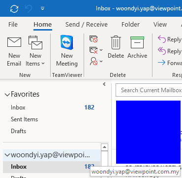

    What I would like to achieve here is to show tool tip text when Ellipsis is detected in the FlexGrid. Is this possible?
    Below attachment is the quick example from Microsoft Outlook:

    I have a better example here:
    The image above is C1FlexGrid with UseCompatibleTextRendering = True to achieve the Ellipsis effect.
    And now, I would like the tooltips to show the whole text when I mouse over it.
    Just like the Microsoft Outlook that I posted above.
    Is this possible to achieve?
