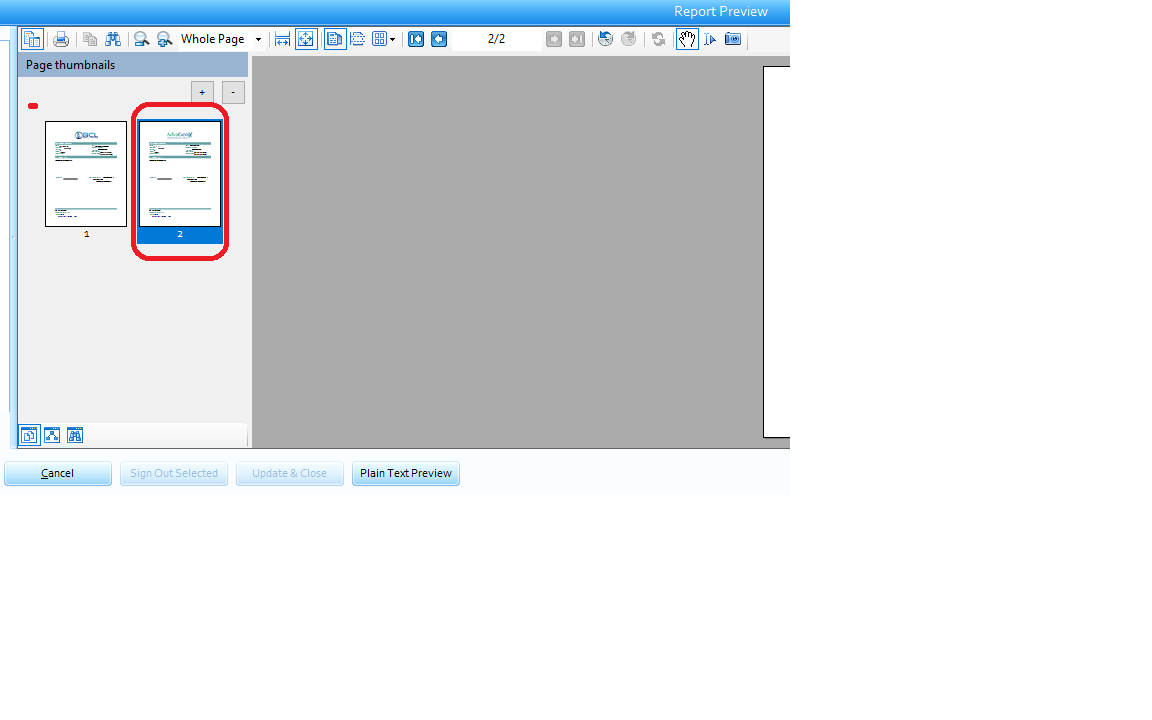

    Is it possible to track when current/selected page is changed (any event)?

  • Posted 14 October 2019, 5:07 am EST
    You can track the same in the Click event of the Thumbnail, as follows:
     private void viewer1_LoadCompleted(object sender, EventArgs e)
                viewer1.Controls[0].Controls[0].Controls[0].Controls[0].Controls[0].Controls[0].Controls[0].Controls[0].Click += Form1_Click;
            private void Form1_Click(object sender, EventArgs e)
                System.Diagnostics.Debug.WriteLine("Val: " + viewer1.CurrentPage);
    Note that the Click event is triggered from the LoadCompleted event of the viewer. Thereafter, the CurrentPage property of the viewer can be used to fetch the current page value. An application showing the same is attached for your reference.
