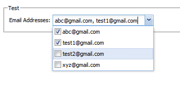

Posted by: eliseu on 9 November 2022, 3:39 pm EST
  • Posted 9 November 2022, 3:39 pm EST - Updated 9 November 2022, 3:44 pm EST
    How to use a Checkbox inside a ComboBox
    I want to know how to do it, Thanks.
    Example in attachments.
  • Posted 10 November 2022, 2:56 am EST
    Thanks for reaching out to us with your query.
    You can achieve this requirement by implementing our C1MultiSelect control.
    Please refer the attached sample for the same : MultiSelectDemo.zip
