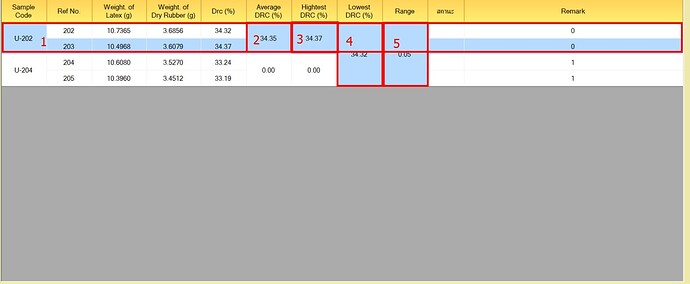

    I am using c1flex grid and i want to merge cell like in this picture
    I have to group of data which each group has 2 record or more.
    the Group number is the first column ‘Sample Code’. I want to merge cell only within the same group but they are always merged like the column with number 4 and 5. Is there any way to solve this.
    I also try to use merging custom but I have no sample.
    Please help.
