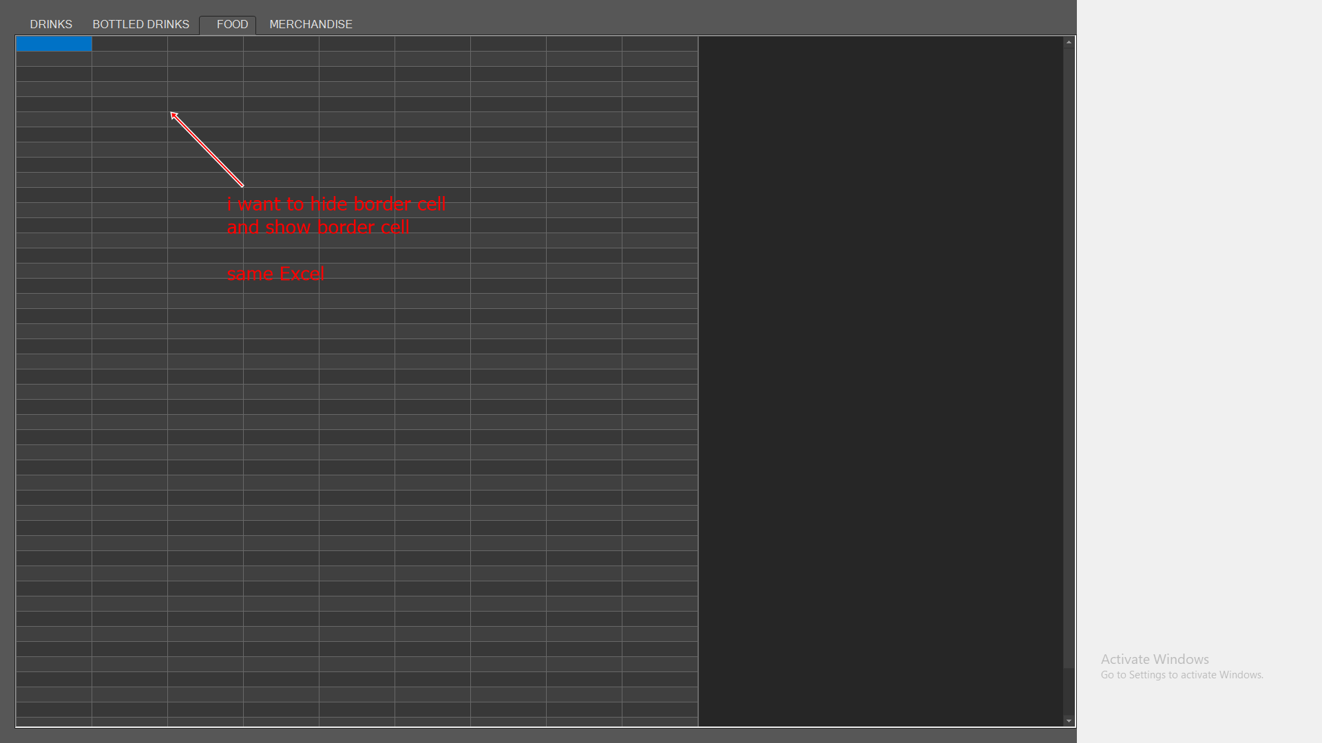

I want to hide and show border cell, same Excel

    ,and i want to show border in under cell, in left border cell, or right border cell
    thank you
  • Posted 26 December 2018, 2:58 am EST
    As per my understanding, you want to change the border of the cell. Please use the following line of code to achieve the same :
      C1.Win.C1FlexGrid.CellStyle cs = c1FlexGrid1.Styles.Add("CellNeWStyle");
                cs.Border.Style = C1.Win.C1FlexGrid.BorderStyleEnum.None;
                cs.Border.Direction = C1.Win.C1FlexGrid.BorderDirEnum.Vertical;
                c1FlexGrid1.SetCellStyle(2, 2, cs);
    If my understanding is incorrect, please let me know.
