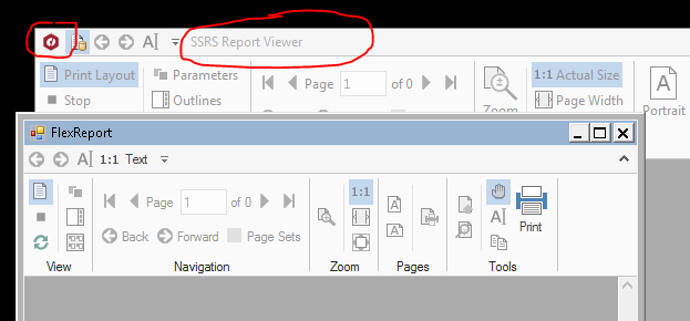

    I am using a C1FlexViewer in my project. I see that if you use a C1RibbonForm you can place an icon on the FlexViewer and also a caption. Can we do this only with a C1FlexViewer.
    See the examples C:\Users{userid}\Documents\ComponentOne Samples\WinForms\C1Document\VB\SsrsViewer for an example.

    Thanks for the answer. Although it’s similar here is what I was hoping to recreate:

    This will probably work for me:
            'tweak the Quick Access Toolbar
            Dim rbLogo As RibbonButton = New RibbonButton(My.Resources.Logo)
            rbLogo.ToolTip = "MyAirlines"
            AddHandler rbLogo.Click, AddressOf Open1_Click
            c1FlxViewerMain.Ribbon.Qat.Items.Insert(0, rbLogo)
            Dim rbCaption As RibbonButton = New RibbonButton("Operations Engineering")
            Dim cnt As Integer = c1FlxViewerMain.Ribbon.Qat.Items.Count
            AddHandler rbCaption.Click, AddressOf Open2_Click
            c1FlxViewerMain.Ribbon.Qat.Items.Insert(cnt + 0, rbCaption)

    This is the best possible way to achieve the requirement in the absence of a RibbonForm i.e. by adding items to QAT at the desired location. However, for rbCaption, you can simply use:
    c1FlxViewerMain.Ribbon.Qat.Items.Add(rbCaption)
