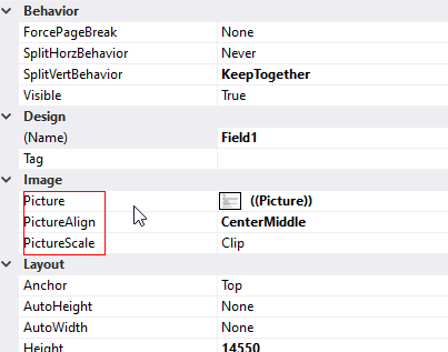

    I am converting one of the older version C1 report into C1Flex report and I have problem with the imageField that Picture is not member of C1.Win.FlexReport.FieldBase .
    Do you have a sample that how can I update the picture location while I run my application ?
    Jeremy
  • Posted 2 December 2020, 3:51 am EST
    You need to cast the FieldBase to the specific type of field to get access to the specific properties, in your case, you have an ImageField, you need to cast the FieldBase to ImageField.
                Dim imgField As ImageField = CType(report.Fields("Field1"), ImageField)
           imgField.Picture = “image_path”
    Please refer to the sample attached. If you have any other questions, please let me know.
