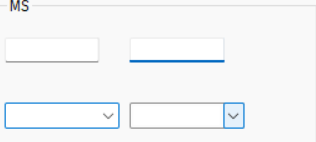

    According to the development team, all of the changes made to the appearance of C1 input controls are in line with the MS input controls. Please see the attached screenshot showing the MS controls for reference.
    The appearance of C1 dropdown controls such as C1DropDownControl and C1DateEdit, for example, corresponds to the default appearance of MS dropdown controls (they too lack underline but have small rounded edges), which is why they do not resemble the appearance of C1TextBox.
    Because of the aforementioned reasons, the development team has no plans to change this because it is by design. Nonetheless, they intend to continue working on Win11 appearance enhancements in 2023. (Including adding support in other controls).
    Also, the development team has suggested setting the C1TextBox.BorderStyle property to FixedSingle to revert back to the previous appearance, as the latest improvements only work for BorderStyle = Fixed3D.
