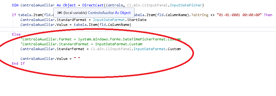

    Yes, I’m using inputDatePicker inside C1InputPanel. The form is linked to a table in a mysql database.
    What I wanted is the following: if the inputDatePicker still doesn’t have a value stored in the read register (if the date is null or does not exist), I would like it not to show the default date in the inputDatePicker, to be clean.
