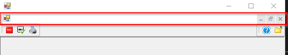

  • Posted 17 June 2020, 7:46 am EST - Updated 3 October 2022, 11:49 pm EST
    Hi Prabhat Sharma,
    Here is a screenshot of your sample with the bar added. I’ve modified your sample according to my program where the child form start already Maximized.
    For arrows, here are 2 screenshots of my program:
    With C1MainMenu, no arrow for CommandMenu
    With ToolBar, arrow for CommandMenu
  • Posted 19 June 2020, 1:49 am EST
    Hi Florent,
    To maximize the child form without the border, use the code snippet in the last attached sample as given below:
     private void Command_Click(object sender, C1.Win.C1Command.ClickEventArgs e)
                Form2 frm = new Form2();
                frm.Show();
                frm.FormBorderStyle = FormBorderStyle.None;
                frm.MdiParent = this;
                frm.BackColor = Color.Red;
                frm.Dock = DockStyle.Fill;
    C1MainMenu and C1Toolbar are two different control so the behavior may differ between them. If you do not want the child menu item and the arrow button, use the C1Toolbar with C1Command only.
