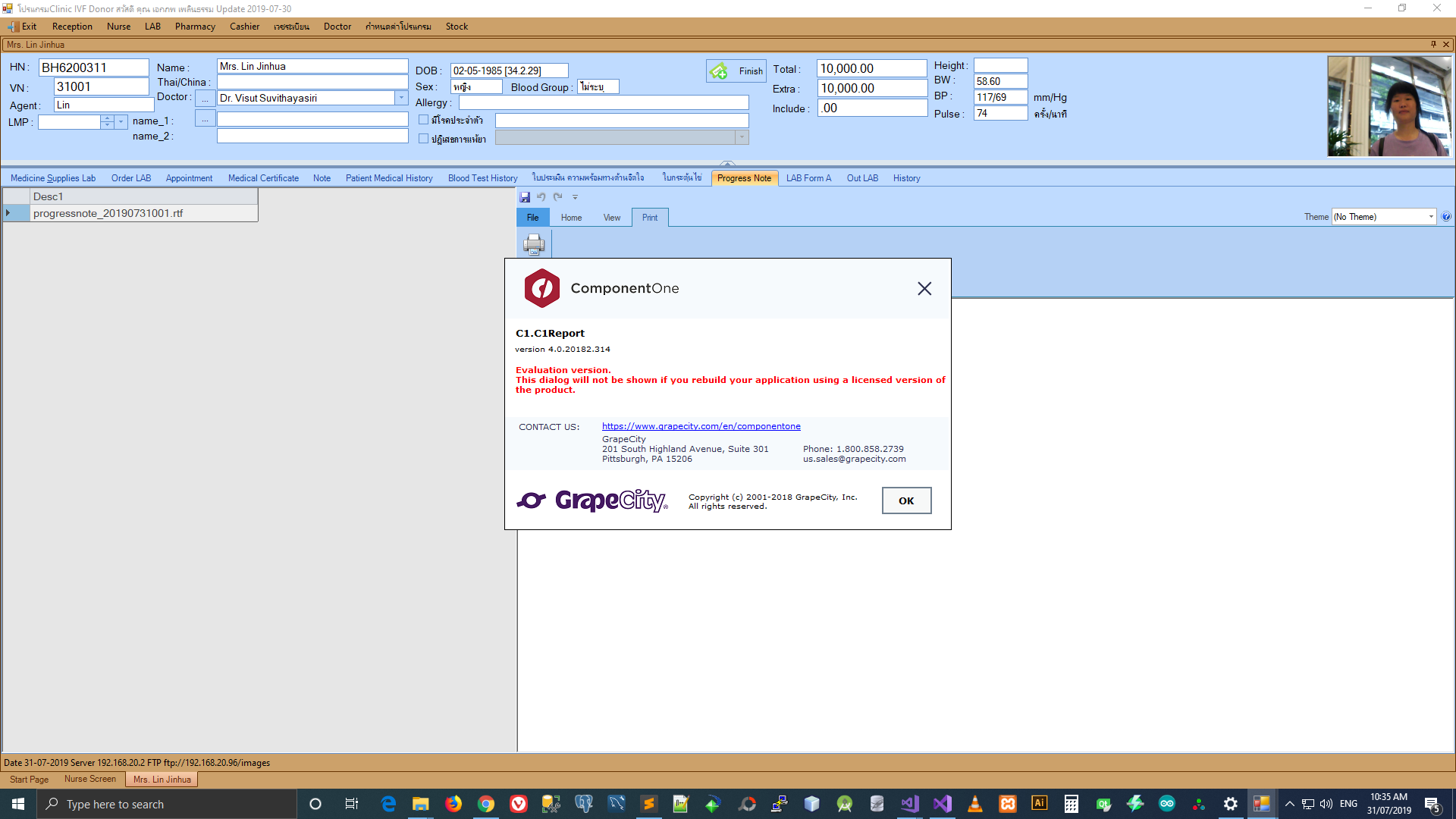

Message license show in c1report
Posted by: eploentham on 30 July 2019, 11:41 pm EST
    Posted 30 July 2019, 11:41 pm EST - Updated 4 October 2022, 12:57 am EST
    how to fix it

    This dialog is shown due to the following reasons :
    1 : The serial key activated on this machine is not valid to use the control version you are currently working with, i.e., 2018V2 in your case. Please confirm.
    2 : The entry of the control (for which the nag screen is shown) is missing in the license.licx file of the project.
    In order to get rid of this dialog, you need to add the following entry in your licenses.licx file:
    C1.C1Report.C1Report, C1.C1Report.4
    Please refer to the following blog providing more information on licenses.licx file:
    https://www.grapecity.com/blogs/licensing-problems-the-licenses-licx-file-and-you

    1. i purchased in May 10 2018 ComponentOne Studio Enterprise
    thank you for answer
    i try new windows app and add C1.C1Report and C1.C1PrintDocument to form
    and open licenses.licx and copy to paste → to problem project
    it OK, it not show dialog message license
