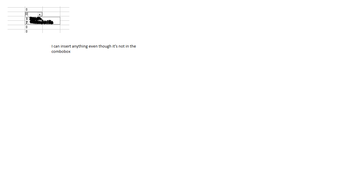

    in vsflexgrid8 the ComboList property can generate multi-column lists. When migrating to C1FlexGrid I use SetCellStyle and MultiColumnDictionary. However, vsflexgrid8 can edit values in cells that are not in the combobox, C1FlexGrid cannot. How can I configure the same side as vsflexgrid8. Can you give me some suggestions? Thanks

    When the MultiColumnDictionary is used as the editor for the C1FlexGrid cells, it only allows input by selecting from the dropdown and not by user typing. To allow input by selecting from the dropdown as well as user-typing, we suggest using the C1Combo control as the editor. Please see the attached sample project for reference.
