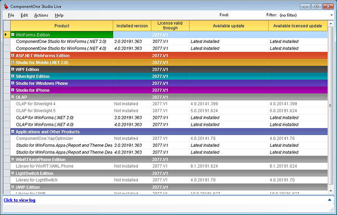

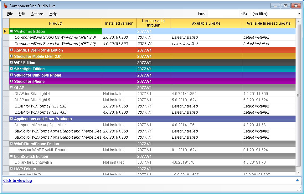

  • Posted 31 July 2019, 5:34 am EST - Updated 4 October 2022, 12:56 am EST
    Dear Ruchir,
    Luckily i could do the deactivation Computer.
    I have registered my licence online and also activate it with the specified tool.
    In C1Live tool i cannot see any more the Winforms (.Net 4.0) that i use in my applications (see bild attached). I the update one urgently because i Need to do correct Bugs in running applications.
    How can i solve this Problem?
    Said
  • Posted 31 July 2019, 7:05 am EST
    Hello Said,
    I can confirm this. We have recently ran into this issue where C1Live is not showing option for updating .Net 4.0 versions for WinForms. The developers have already been informed and they are working over this to fix it as soon as possible.
    Meanwhile, to use latest 4.0 version assemblies I regret to inform you that you need to uninstall ComponentOne and use the latest WebInstaller available here: https://www.grapecity.com/download/ultimate.
    Though, the C1Live issue would still be there, it would properly install the latest 4.0 version assemblies on your machine which can be found at C:\Program Files (x86)\ComponentOne\WinForms Edition\bin folder location.
    Ruchir

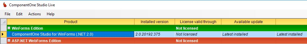

  • Posted 31 July 2019, 7:39 am EST
    Dear Ruchir,
    Can you please confirm that after doing this, i can use my License for it.
    Otherwise i will always get the licence popup window that says it is not an official license.
    Na
  • Posted 31 July 2019, 10:54 am EST
    Dear Ruchir,
    I have done the following as you said:
    1. I deinstalled all the Component one.
    2. i could not install from the web because of the Proxy. So i Download
      C1Studios_20192.1.3 from the link and installed it.
    3. I checked the Folder ComponentOne , i can only see “C:\Program Files (x86)\ComponentOne\bin\v4”
    4. The question is where are all other modules like C1Flexreport and all other Folder?
    I do not understand what is going on and i am in Trouble now. Applications has to be maintained, Reports has to be maintained and new must be done. All the Company is crying and i cannot do anything. The work is stoped.
    The uninstall took me a half day.
    I Need please a solution to get everything running like before.
    Said
