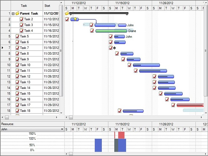

    I am trying to create a GanttView resource capacity chart in a table under control like the image below. Do you have an idea ?

    My need is rather to show the number of hours or the percentage of use per resource (or per a group of resource). For example, if a task is assigned to “Fred” for 3 days and another task to “Fred” for 5 days with common days, then the graph shows a use of “Fred” at 100% for 2 days and at 200% for 3 days.
    The display of the capacity would be a huge function of the control.
    Sébastien
  • Posted 28 November 2019, 2:43 am EST
    As per you given screenshot we can say that the bottom portion is similar to some other control like FlexChart.
    Currently it not possible to show “Resource Usage in GanttView” so we are requesting for a enhancement to show “Resource Usage” in GanttView, will let you know once we get any updates on this from the developers.
