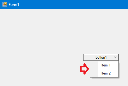

    In .NET 4.8, I could create a separator with this code:
          DropDownItem item = new DropDownItem();
          item.Text = "-";
          this.button1.Items.Add(item);
    And it looks like this:

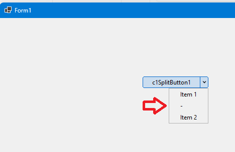

    With .NET6, this does not work any more:
          SplitButtonItem item = new SplitButtonItem();
          item.Text = "-";
          this.c1SplitButton1.Items.Add(item);
    The “-” is rendered as a regular text:
    Is there any other way to achieve separators, or is this just a missing feature?
  • Posted 1 June 2023, 1:18 am EST
    Hi Wolfgang,
    Unfortunately, this feature is currently missing in the .NET 6 C1SplitButton. An enhancement request for this feature has already been raised to the development team and the ETA is 2023v2 release. We will let you know as soon as this feature is implemented.
    [Internal Tracking ID: C1WIN-29558]

  • Posted 3 August 2023, 4:24 am EST
    Hi Wolfgang,
    We are happy to let you know that this feature has been added in the latest 2023v2(611) hotfix release. You can install the latest NuGet package using the link below.
    (https://www.nuget.org/packages/C1.Win.Input/6.0.20232.611)
